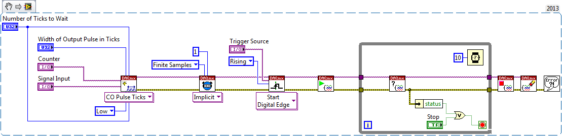

Hey, George
I do have a suggestion for you. Here's some code that will delay a set number of pulses of an input signal. If you input a 1kHz signal, then waiting 300,000 ticks would correspond to 5 minutes. You may have to use another counter to generate a pulse train signal that acts as the 1 kHz input, but this code is how you can do they delay. After the 300,000 ticks are counted, a pulse of a specified width is outputted by the counter which you could use as a start trigger for another task.

Thanks for reply.
How do you do that ?  I don't see a start event for CO.

Hey George,
Do you mean how do you use the pulse that this code generates as a start trigger for another task? If so, you would use the DAQmx Export Signal VI which would allow you to export the "Counter Output Event" of this task to a PFI Line of your choice, which could then be used as the source for the trigger of another task.
