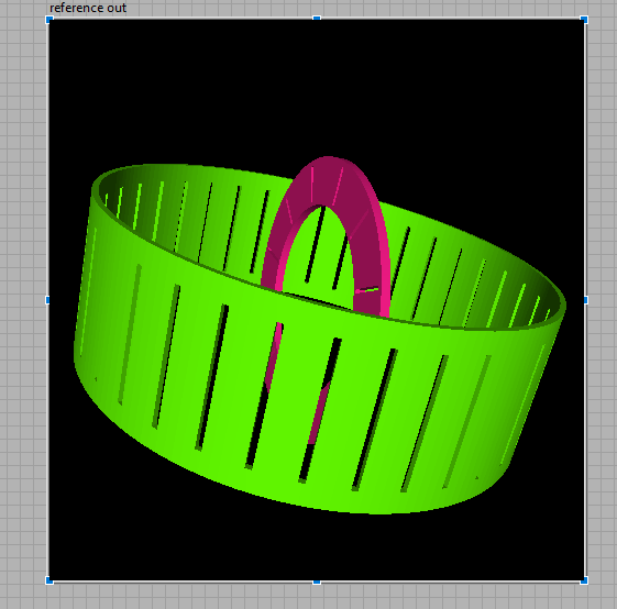

Dear sir - With reference to the above artificial horizon application , we want to add the arrow mark that needs to points the heading value. If we create the arrow mark in .jpg / .stl file and when we add the same into the above horizon 3d object, the inner roll and pitch image has vanished. We couldn't able to add the more pictures into that as per our customized requirement. It would be very great , if you can guide us to accomplish this task. Please do the needful.
With Regards,
Jayanthi K
Message 3 of 9
(4,994 Views)
Show your code and .stl

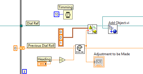

Dear sir,
Pls find the attached file.
Regards
Jayanthi
Message 8 of 9
(4,940 Views)
Jayanthi.
first of all you need to study 3D.
This is your objects. Call AutoFocus method and you'll see it.
and here you add new object to scene 100 times per second. What for?
