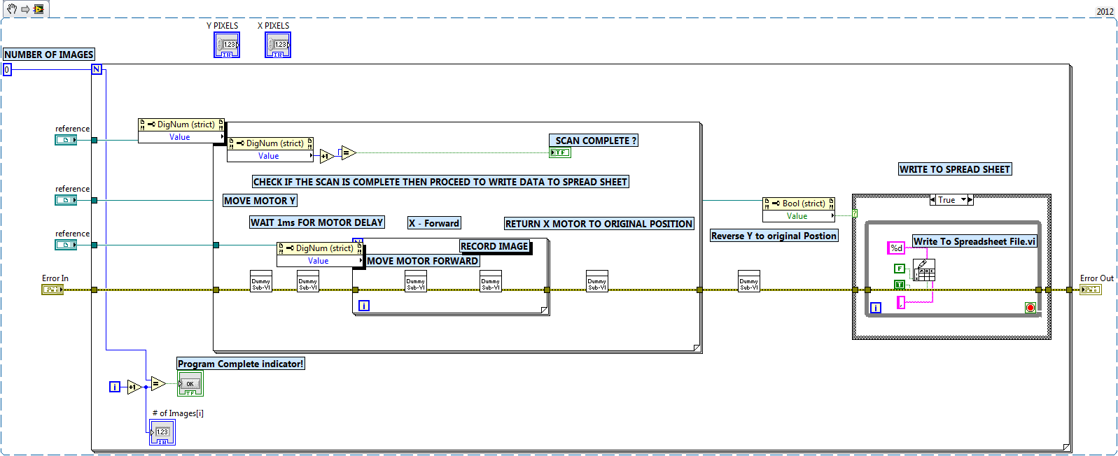

My own personal preference is to never use a Flat Sequence (unless dragged kicking and screaming).  Most VIs have the Error Line running through the bottom corner -- you can enforce Data Flow (which you are also getting with the Flat Sequence) simply by connecting Error Out of the first VI to Error In of the second.  Look at your diagram, and imagine how it would look with no frames, but with an Error Line running through it ...
Here's a picture of what I'd do.  Note I've used a "Dummy Sub-VI" everywhere -- you would, of course, have a "Move Motor Y", "Delay", "Move Motor X", etc. VI, each with a clear icon so you could look at the Block Diagram and instantly see (without the Big Blue Labels) what is going on, and with the sequence "defined" by the Error Line running through it.  Your Diagram will be much easier to read, much less cluttered, and can be much smaller (so it fits on a single screen).  [Note that an important part of this trick is writing all of those sub-VIs -- Sub-VIs Are Your Friends ...].

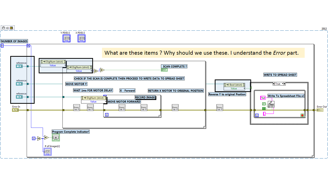

Thanks.
There are quite something that I dont understand from the figure you posted. What are the "references" [ please see the highlighted boxes in the edited figure you posted below] , why should we use them ?

Those references are caused by flaws in the built-in VI snippet tool.  It takes the implicit property nodes and breaks them into a reference and an explicit property node.  I'm sure on Bob's real VI, he did not have those reference controls, just property nodes that were implicitly connected to a particular control.  The problem with the built-in VI snippet tool is that it breaks that connection, and now you don't know which property node was linked to which control.
The better solution is if Bob had used the Code Capture Tool.  It does not break the references.  It leaves the property nodes intact.
Please go and vote for the idea Treat Code Snippets as "Copy and Paste" instead of "Create Sub-VI" to fix the built-in VI snippet tool.
