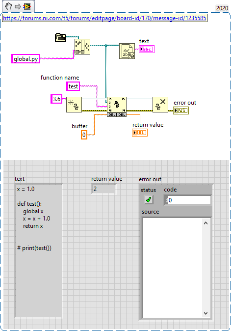

ok, thanks for the kudos+ - but now, I am curious ...
it looks like you have to update globals like this
Spoiler
x = 1.0
def test():
    global x
    x += 1
    return x
print(test())
this will print 2 if run in cmd or via visual studio code
but when run the exact script via python node, I get 3 instead of 2 - when commenting out the print command  # print(test()) , the return value is 2 as it should be
