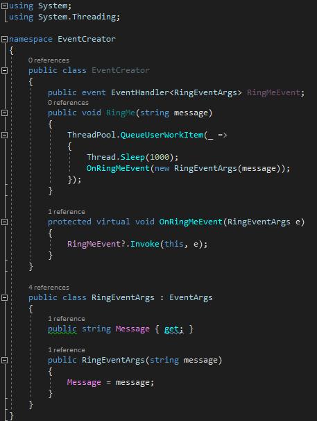

Here is a simple example I created in LV2016 with a basic assembly targeting .NET 4.0 framework (CLR 4.0). You call a method of the class for a message you would like it to send back to you (via an event) 1000ms later. The thread that actually runs LabVIEWs callback VI will be a ThreadPool thread created by the CLR; I did this deliberately to demonstrate the limitations of debugging callback VIs. This works fine on my machine; maybe you could try it on yours.
The code for the assembly is below:
