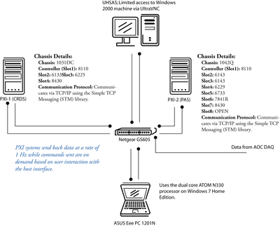

OK, so it looks like there is some definite interest in this which forces me to respond without everthing that I wanted to show.
Some background first...
This netbook is being used as a host interface to interact with two PXI chassis', a Window's 2000 machine and an aircraft data acquisition system (this instrument is being deployed on a P3 for acquisition of measurements characterizing aerosol light absorption/extinction in the atmosphere).  Unfortunately, I (as others) was under the impression until about a month before deployment that each chassis would have it's own individual interface, and therefore we had no network communication nor a platform for the host (hence my initial inquiry here).  So, for the past month I have been struggling to aggregate all of the data acquisition into one simple UI for the two instruments.  If I had my druthers, the systems would have been RT thus junking some of the jitter associated with running the DAQs on Window's machines.  C'est la vie...
The setup...
Though I am still working to get all of the communication in line, my initial impression is that the Asus Eee PC 1201N is an excellent platform for the work that I am trying to do.  Most of the heavy lifting is done by the two PXI chassis', leaving only the data storage and display to the host (the Asus netbook).  The network topology looks like this:
The two chassis' and the  host are communicating via the the STM library; data is shipped from the two chassis' at a rate of 1 Hz.  On the CRD side (PXI-1) the controller sends back a series of 16 signals representing mean exponential decays acquired at 1 kHz.  These represent the bulk of the data that is shipped - the data itself is decimated before transmission and the signals are each represented by about 80 to 100 integer words.  Including reduced data and housekeeping, the amount of data sent back is quite small - maybe around a couple of Mbs.  Controller 2 (the PAS) sends back considerably more data (about the limit of what is  allowable in terms of bandwidth) representing snapshots of a time domain signal and the resulting frequency domain signals (acquired at a rate of 250 kHz).  All of this data is displayed as it is acquired (1 Hz) with the user being able to send commands asynchronously via the Event Structure.  Data is saved at this same rate (1 Hz) to binary files for both instruments.
Now my impression...
I am currently running Labview 2009 with SP1 and no real issues regarding installation.  My initial impression is that the dual core ATOM with the stock 2 Gb of memory is more than sufficient for our needs.  There is a lot of  Asus bloatware that is shipped with the computer, but it is easily removed.  In regards to developing with this computer, I would suggest updating to the maximum amount of memory that this computer can be expanded to (4 Gb) - the performance can get kind of jumpy and everything kind of slows down when you call things from the Quick Drop menu - and the screen is quite small (but has awesome resolution so you will be amazed at what can fit on it).
That being said, I would definitely recommend this little netbook.  However, as stated before, everthing is not quite complete, so I will provide more info and probably put up some snapshots of what we are actually displaying as well as any hiccups encountered that I have not noted here.
Hope all of this helps.
Peace, Matt
