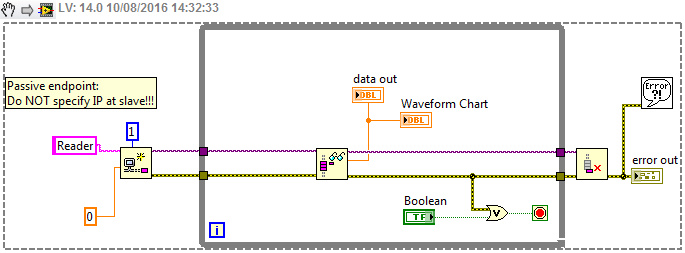

After some testing using two laptops on a local network, I got some idea how to handle possible crashes. There is of course a difference between a network outage or when the application itself crashes. I tested network problems by turning temporary the network off on each of the laptops. It looks like the Network Stream handles such scenario well: either I turned off the network at the active or at the passive endpoint, it recovered after turning it back.
Of course, in my real application I will wrap up the NSs into an Action Engine, and I will use some timeouts and handle these errors. In this case, even if I need to restart either the active PXI or the passive one, the Network Streams will automatically recover (need to program some state machine which tries to reconnect the endpoints in case of timeout and other errors).
Active endpoint side:
Passive endpoint:
