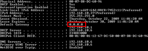

It sounds like your problem might be slightly different, but I am not sure what might be happening.  Can you check your Local Area Network Connections settings before and after the install?  You can do this from the command prompt with the command "ipconfig /all".  The Bonjour issue would result in an IP Config that looks something like this:
Hence, "route delete 0.0.0.0" would remove the unwanted default gateway of 0.0.0.0.  Hopefully the exact behavior you are seeing will be more clear after taking a look at the ipconfig.

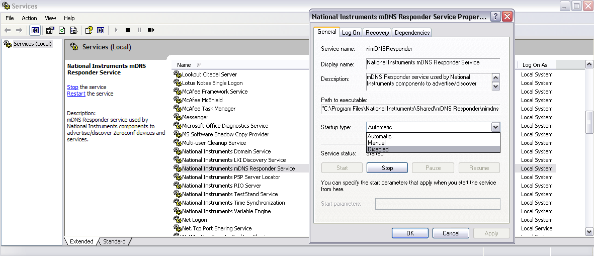

Also, I would try disabling the"National Instruments mDNS Responder Service" (from services.msc😞
You should reboot after doing this.
