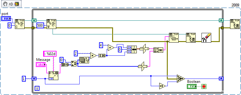

This is the vi that should connect to my client.
When the connection is established, it should send the message in the control, the problem is that it never connects.
The vi is very similar to the example vi.
I can't see anything wrong with it, do I need to add something?
I would like to add that the ClientSide.vi can receive the data perfectly even on another maching, so I guess that it's not a matter of firewall.

Have you run this VI with execution highlighting enabled (the light bulb in the toolbar) to see what it's doing?  Checking for error 56 is not sufficient - there could be some other error code.  Also, once you do get a connection established, you'll again have the problem of mismatched string encodings - LabVIEW will send an ASCII string, but it seems your C++ code expects a Unicode string.
Message 8 of 13
(6,225 Views)

I did, it only gives me ERROR 56.
I think I understood what the problem is.
I tried to make the vi into an executable, when I run the executable a dialog from Windows firewall pops up, so I guess that is a firewall issue.
It's very weird by the way, because the firewall pops up when I start to listen for incoming connections, not when my C++ program tries to connect to the LabVIEW vi.
I don't really know a whole lot about firewalls but it does not make too much sense to me, because when I run the vi within the LabVIEW environment there is no firewall dialog. 😞
