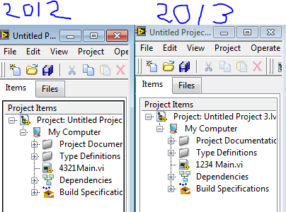

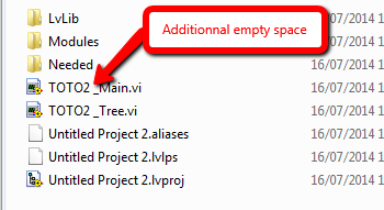

Sorry if I wasn't clear...
- 1st enclosed image is my project template configuration dialog box : I want to add "TOTO" (no empty space) as a file prefix
- LV2012.png is my generated project in LV2012 : my VIs are prefixed with "TOTO" (no empty space)
- LV2013.png is my generated project in LV2013 : my VIs are prefixed with "TOTO " (with an empty space)
The problem is that in my template, I needed the file prefix of my project to get the path of an error file called TOTO_errors.txt that is additionnaly generated with a post action script. So in LabVIEW 2013, the file prefix I get is incorrect ("TOTO " - with an empty space) and then I cannot get the correct path to my error file.

That is an unfortunately undocumented change
I have to admit I approve of the space (It centers the text of the banner in the icons that would otherwise get a "_")
Getting to "TOTO_errors.txt" from either version is only a trim whitespace away in your post action script and should maintain backward compatability.

We changed the prefixing in LabVIEW 2013 and later to add a space after the prefix. However, it does not add the space if you include an underscore in your prefix. Is your post copy scripting code adding the underscore to all generated items after the project is created?
Message 5 of 8
(4,178 Views)
Oh hey, guess what? I forgot that we added an INI token to disable the new behavior. If you add this token in LabVIEW 2013 or later:
NewProjectNoAddedSpaceOnPrefix=TRUE
Then you'll get the same 2012 behavior of no space being added to the prefix. If you want to see the code that handles all of this in LabVIEW 2013 and later, check out this VI:
resource\dialog\NewProjectWizard\Project Copying\Add Space to Prefix.vi
