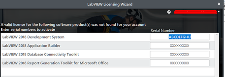

  1. Are you going from the LabVIEW Licensing Wizard that pops up when you launch LabVIEW? I performed the steps from the LV Activation Wizard, and I was able to batch activate all these products. The functionality itself has not been removed from LV.

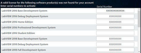

If you launch the Wizard by clicking Activate Software in the NI License Manager, you will receive more options of products available to activate:

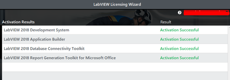

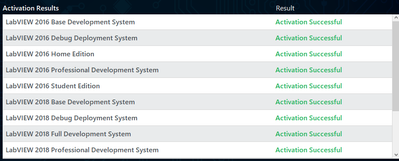

In my case, the result of the batch activation was also successful. The functionality is still there.

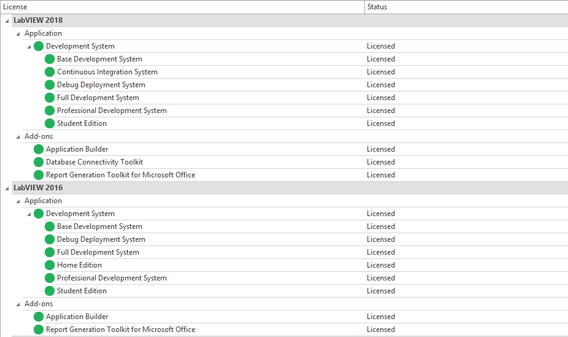

This was the end result as seen from the License Manager.
