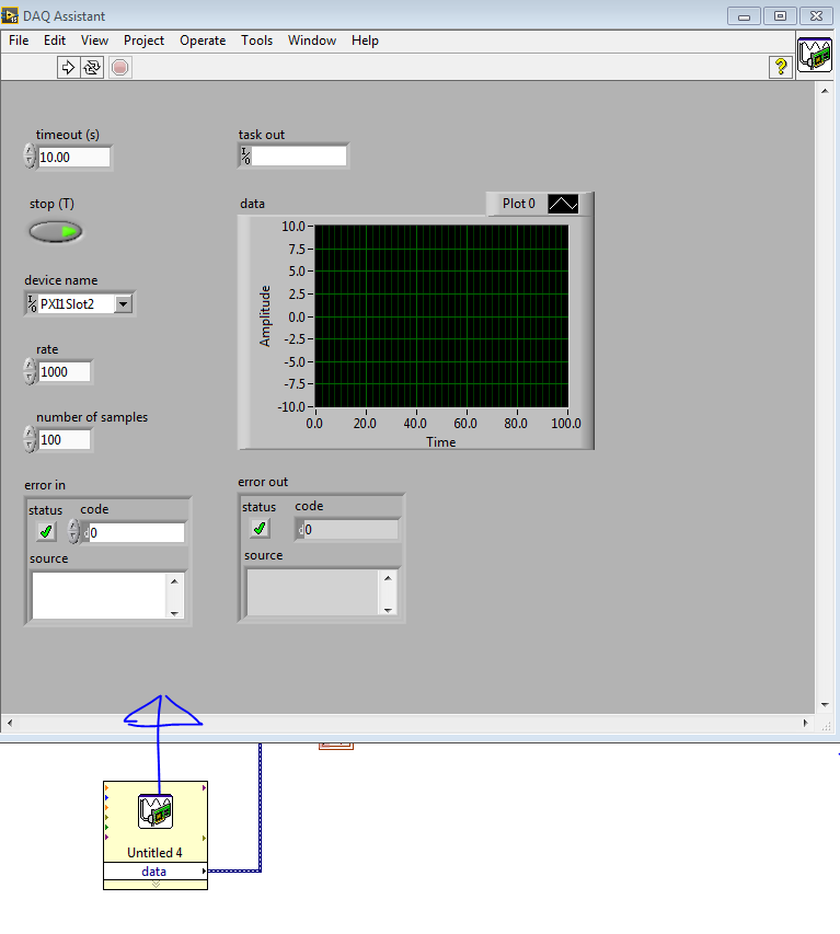

cmorrow8, what  Dennis_Knutson and crossrulz are saying is that you have to open up (in another window) the 'Read AI Task'.  If you double-click on the 'Read AI Task' icon, it should open up another window.  That window will be the front panel of the 'Read AI Task' vi.  On the front panel, there is likely a field where you can select which device you want to be reading from.
Whoever wrote the code created a sub vi to package things together.  In order to change what this vi is reading we have to go into the subvi to change the fields there.
For example, this is how the DAQ Assistant express vi looks like when it is opened.
