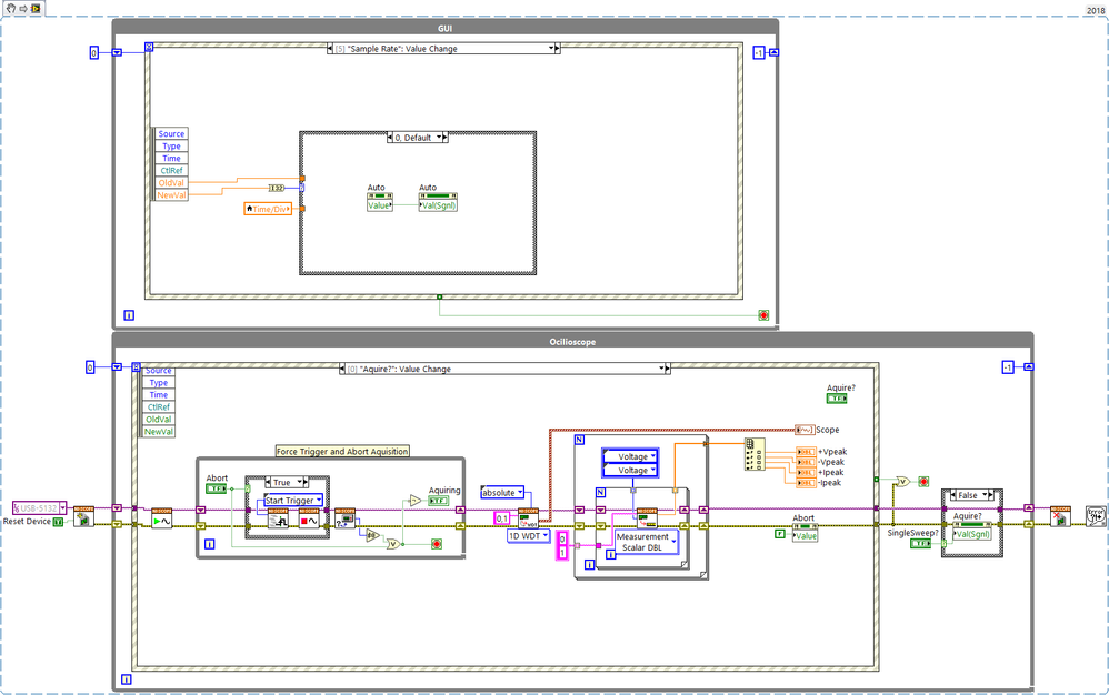

Go to the View in the menu and and open "Event Inspector Window"
I have not looked in detail at your code, but you have multiple event structures and value signaling properties. I wonder if your Event is getting triggered twice, then two acquisitions.
The Event Inspector Window has a log of events, check if that is the case.

Can someone inline a png or snippet?
My 8-Ball is telling me that you are making a simple mistake and probably should be using a start-fetch rather than a start-wait-read.

Message 8 of 16
(4,055 Views)
Dang,  I still can't tell from my phone...McDuff, can you print the lower loop and inline the png?
