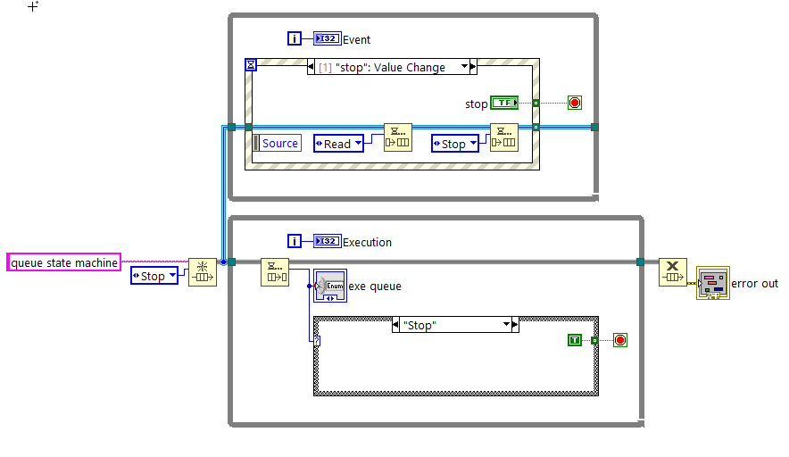

I've attached a simple VI and subvi. The main VI consists of a producer and consumer loop, event structure in the producer loop, case structure in the consumer loop to handle processes
The problem I am facing is that the consumer loop goes through an extra iteration upon stopping the producer loop and releasing the queue. Further, during this extra iteration the dequeue element spits out an extra item that I can not track down. The queue should be empty, so where does this extra element, which is always 0 ("Initialize") in this case, come from? I've tried adding a "Read" to the stop event, which does enqueue a "Read", but the extra (last) element is always 0 ("Initialize").

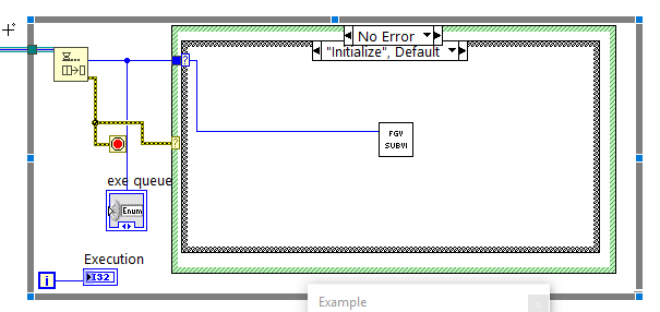

You are stopping your loop by destroying the queue reference. When you destroy the queue reference, the dequeue operation dequeues the "default" value of the queue data type, which for your case is 0.
You can avoid writing to your FGV by wiring a error case structure if you want to keep the same structure.
See below.

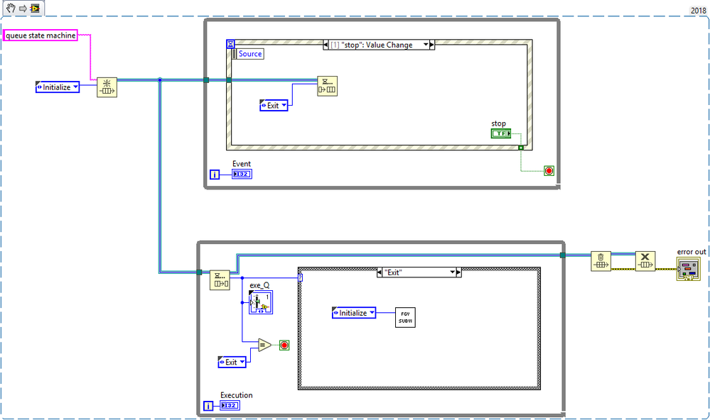

Thanks for the quick reply! Did not know that the queue releases the data type itself at the default value after the reference is destroyed.
In this case, to maintain the same structure would I implicitly stop the consumer loop instead of wiring the error out of the dequeue to stop?
edit: attached my alternative that maintains structure.

Add an "Exit/Stop" State to you Enum, then stop your consumer when it gets the command. See below. Also make your enum a type-def. Then destroy your queue from the consumer loop.
