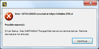

I tried running the Example VIs, but I continue to get errors where the resource for the grandmaster is not seen by the Laptop:
I did change the Time Reference to the "1588 Ordinary Clock".
I also added the IP addresses of the PXI into the test VIs.
I also attached the altered example VIs for reading the 1588.

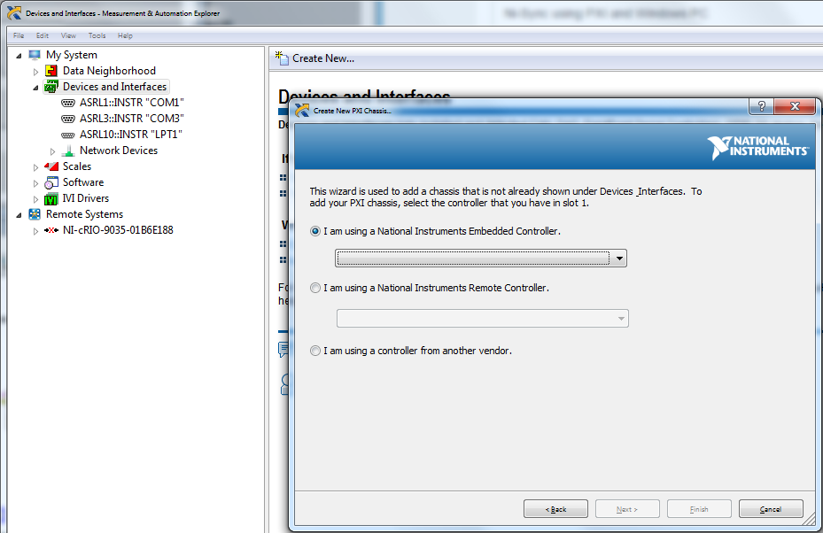

1) Does the PXI have to be listed as a remote system on the Laptop?
Please look here @ figure1:https://knowledge.ni.com/KnowledgeArticleDetails?id=kA03q000000x38BCAQ&l=en-US
2) Do I need to add the PXI as a VISA resource on the Laptop in order to pull the NI-Sync Clock from the PXI grandmaster?
3) I have no idea which one of the attached VIs are meant for reading and which is meant for writing to the 1588 clock. Which one should I have on my Laptop which reads in the 1588 grandmaster clock sent by the PXI?
4) Do I need to have the PXI added as a remote device on the Laptop?
The PXI is not showing up in MAX on the Laptop.

Hi Keith,
Thanks for your detailed problem description. In answer to questions 1&4, if the PXI controller is running a Real-Time operating system then yes, it should show up as a remote system in MAX as seen in that tutorial. However, if the PXI controller is running Windows it shouldn't show up under remote systems, it behaves just like any other PC on the network so to access it you can either remote into it or connect a monitor and keyboard.
As regards to questions 2&3, I'm not sure yet with your specific setup, I'll look into those VIs some more and let you know if I can come up with anything. Thanks!

Hi Keith,
Is your PXIe-8135 controller running Windows or RT? As Selene mentioned, this will impact what you’re supposed to see in MAX, as well as how you run the NI-Sync examples.
If it’s an RT target, you will need to add it under Remote Systems in MAX and then deploy the example VIs to it in LabVIEW. If it’s a Windows target, you will not see it in MAX on your laptop, and you can just run the example VIs directly on the controller. Either way these examples need to be run on the target itself, not your laptop. You should run both Set Time Reference and Start 1588 and Wait for Quality on the controller to begin participation in 1588. Once those VIs are running, you don’t need to do anything else on the PXI side. You just need to connect the NIC of your PXI-6682 to the network with your laptop.
As for your laptop, you will need to use the Greyware software you mentioned, or some other 1588 client to act as a 1588 slave because LabVIEW doesn’t have a 1588 client on Windows. I’m not very familiar with how these clients work, but I imagine it probably synchronizes the Windows system time. If that’s the case, you wouldn’t need to directly interface with the client from LabVIEW. You could just read the OS time from LabVIEW.

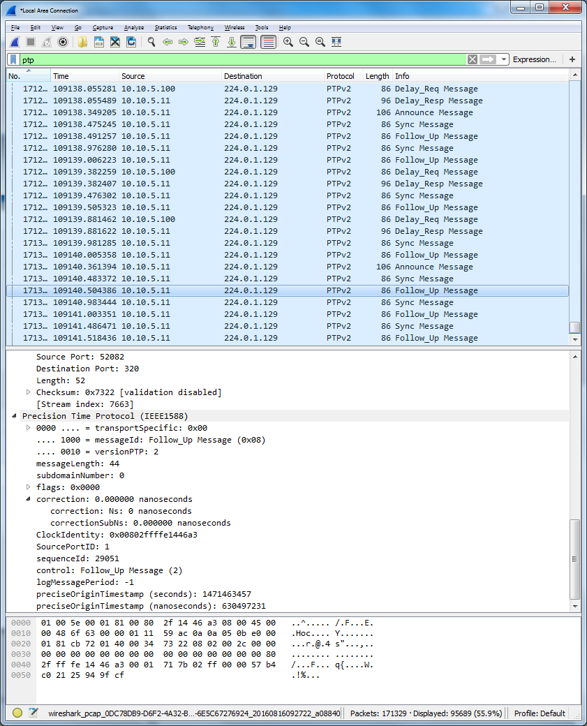

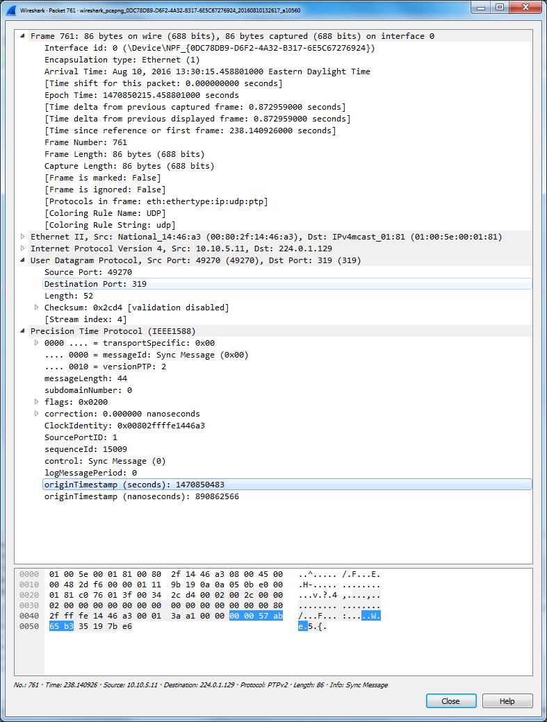

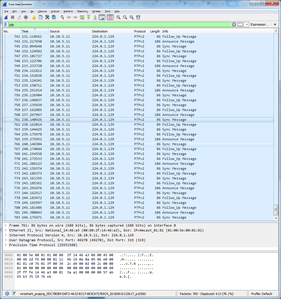

I am able to see the timestamps using Wireshark (well known ethernet network debugging tool).
I see that the PTPv2 protocol is accessible using UDP communications.
Please see this article: https://wiki.wireshark.org/Protocols/ptp
I added a "ptp" filter in the top filter bar to make wireshark only show 1588 PTPv2 comms from the PXIe.
I am able to get the output and in returns the format of dat/time in seconds and the time is immediately followed by the nanoseconds.
I double mouse clicked on the Event in wireshark and the entire UDP PTPv2 packet can be seen!!!!!! AWESOME!!!!

The LabVIEW program works by changing the Windows System Time when it receives "Announce Message" updates from the PXIe grandmaster over 1588 PTPv2, but there seems to be a significant delay while the LabVIEW code runs on the Laptop end.
The Program works by interfacing with the open-source "WinPcap library" to pull the raw Ethernet traffic into LabVIEW. It calls multiple functions in the "lvwpcap.dll" file.
I then pulled the additional 1588 PTPv2 information using Wireshark as a template (Wireshark had descriptions on each byte in the 1588 PTPv2 packet, so everything was identifyable).
