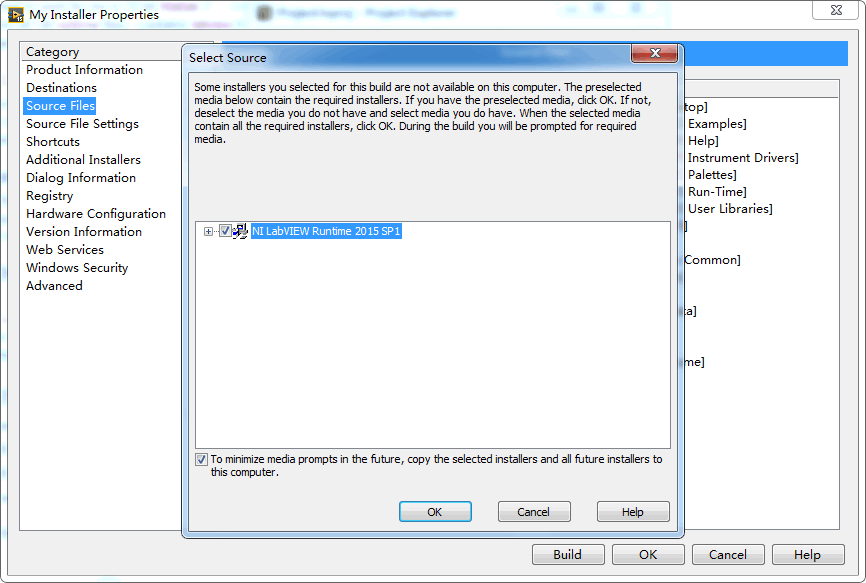

No LV runtime when build an installer.

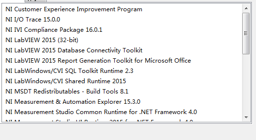

I build an installer of a small program in Labview Profession Development System 2015,and it prompts  me to select the media path for Labview runtime, which seems not available on my computer.
What does this mean?As far as I know , in development system of Labview,the runtime stuff is already included, right?
So how does this happen and what can I do?
(2,576 Views)
But the installer for the Run Time Engine is not currently on your machine.  If you still have the install discs, just insert the one that is being asked for.
