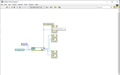

Hey Everyone.  I've got an Excel template and I'm filling in cells with data.  Pretty simple, I've done this before.
However, the ActiveX property and invoke nodes are showing no methods and no properties.
Using Windows 10, Latest Excel (and yes, it's installed), LabVIEW 2019
Am I missing something?  Is modern Excel only driven by .NET now?  Which assembly would one use to drive Excel with .NET?

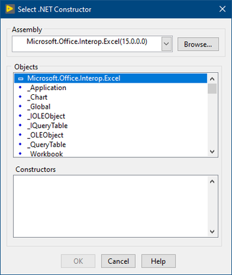

Someone suggested running a repair of your Office install might fix it.
In my office it seems to work like "magic"... sometimes it'll work on a PC, sometimes it won't.  I have a desktop where it doesn't work and a laptop where it does.
You can use .NET though.  The "Microsoft.Office.Interop.Excel" assembly has basically the same stuff as the ActiveX did, plus a few extra things:
