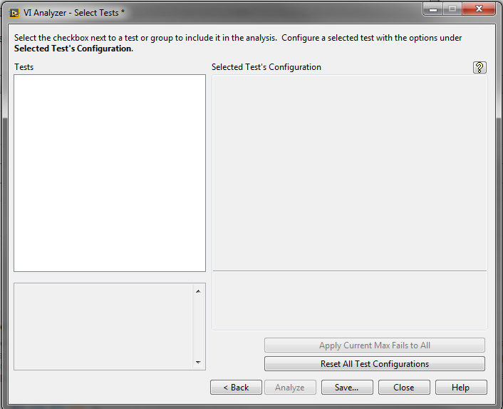

I do not see any tests available in the VI analyzer window, does anyone know why this could be?

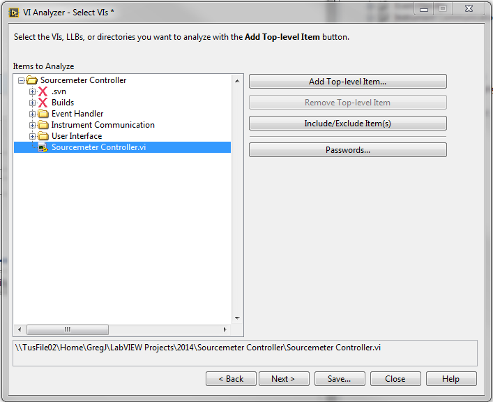

I can open up the VI Analyzer in the tools menu and select some VIs:
When I click "Next" I do not see any tests available:

Repairing the VI analyzer install fixed the situation.

The VI Analyzer Toolkit is included in LabVIEW Professional but it is also its own entity that can be seen within the NI License Manager, but to download the toolkit again you can find the installer at:

Thanks! Downloading and reinstalling it separately helped indeed! It added the previously missing folders and libraries to the "C:\Program Files (x86)\National Instruments\LabVIEW 2015\project\_VI Analyzer" folder.

This is happening to me in LabVIEW 2017 x64.  I used NI Package manager to uninstall VI Analyzer and then downloaded the latest version and installed it.   Tests window is still blank.  Any ideas?

I used NI Package manager to uninstall VI Analyzer, then I used the downloaded zip file from the direct link to install it.
My directory
C:\Program Files\National Instruments\LabVIEW 2017\project\_VI Analyzer
contains the same files you listed.  Looking at the "_tests" folder, I see various test categorys and subfolders and lots of llb's under them.
