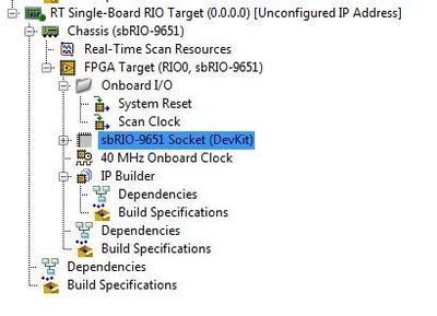

The sbRIO-9651 is a bit different from our normal FPGA targets in that it's meant for custom board designs using the 9651 System on Module.
http://www.ni.com/white-paper/52314/en/
Because of this, the 9651 needs a reference to I/O definitions to "know" what I/O is available. This is done through the sbRIO-9651 socket in the project. socket.JPG
I'm assuming you're using our prototyping/reference board version of the device. If that's the case, simply right-click on the Socket in the project, and choose "Properties." In the sbRIO-9651 Socketed Component Level IP Declaration dropdown, choose "Browse" and select the correct file for your device. The file path should be called out in the sbRIO-9651 Quick Start Guide that came with your developer kit, but if not you should be able to find it here:
C:\Program Files (x86)\National Instruments\Shared\CompactRIO\CLIPs\sbRIO-9651\DevKit
Once you ensure that it's selected from the dropdown, your I/O should appear under the socket.

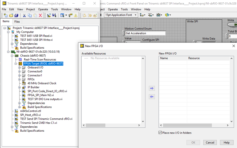

My sbRIO is a 9637 with LabVIEW 2017 SP1 and RT 17.6 installed.
There are no errors, I can run FPGA and RT code fine..But I the 'New FPGA I/O' properties browsers shows NOTHING for avaliable I/O.
What gives?
