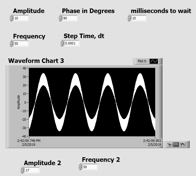

I have made a continuous sinewave generator using basic sine function and plotted it on the waveform chart.
I want to add two waveforms of different frequencies. I have sampled both waveforms at same dt.
But when I try to add the waveforms with different amplitude or frequency and plot it, I get unexpected results.
It seems that there is some problem with sampling. I don't know what it is.

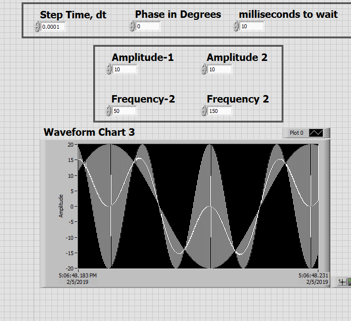

My expected results should be according to Fourier series, that I should be able to a resultant of a sum of sinusoids of different frequencies.
I have edited the subVI and connected the same t0 to both instances. But again I don't see expected results. I see the following

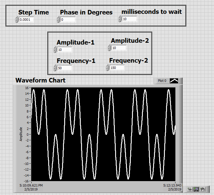

But this time I was successful in getting the results.
I removed the subVI and instead of adding the waveform of the two sinusoids, I first added the array outputs of two sinusoid waveforms and then built the resultant waveform using build waveform.vi.
I think there is something wrong when we try to directly add the waveform data.
