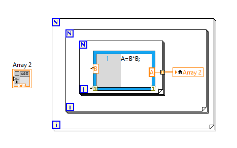

In the pic you can see another example. In this example I would like to know how to delete from the Mathscript node the variable "A" and "B", but after the output A has been read. I would like to know how to delete the variables inside the Mathscript node after each iteration. The real code I have inside the node structure is a lot of matrix and vector multiplications (and element-wise multiplication).

What's the point of the local variable. It makes no sense in the current code. Also, why does the indicator needs to be updated in the innermost loop?

What is going to be driving these loops? Right now the outer two loops will do nothing (or at least nothing useful) and the inner loop will llikely generate the same results everytime.
Do you have the N terminals of any of these loops wired? If so where is the number coming from?

The second picture was just to explain what I meant with labview variables. I meant the nodes outputs:I just want to delete all the variables from the node once the variables are read in the outputs. Actually please ignore the two outer loops, the question would still be the same if I had only the most inner loop.
The local variable is in my real VI a global variable, because I then call the values from other VIs (also ignore the two outer loops, because usually they will run only 1 time.)
