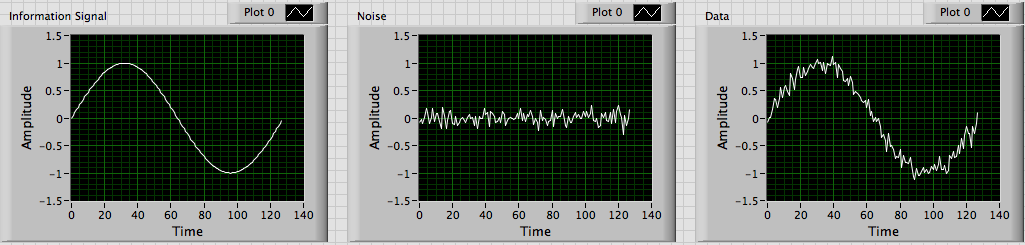

Please tell me more about the signal. The term "noise data" is not commonly used in English so I think we may have a communication issue.  "Data" is usually applied to the part of the signal which carries useful information, although it can also be used to describe the raw measurement of the total signal plus noise. The term "noise" almost always is used to describe a random component which contains no useful information.  The word "signal" - like "data" -  can be used to refer to the information component or the total of information plus noise.  There can also be "interference" which refers to a signal component which may carry information but which is not the desired information.
Let me use the term "data" to refere to your digitized measurement before any other processing.  I will use the term "information signal" to describe the part of the data which carries the desired information you wish to extract from the data. And I will use "noise" to describe the random component of the data. The image below shows a simple example.
What does your information signal look like? What are its frequencies and amplitudes? What information about it do you need to measure?
What does the noise look like? What is its amplitude?
What generates the information signal? What generates the noise?
Sometimes filters are good methods of reducing noise while in other situations different methods work better.
