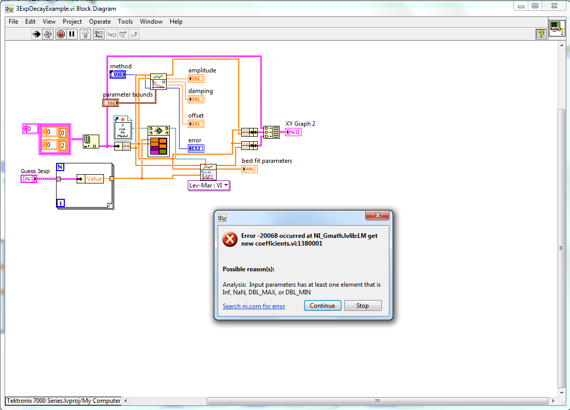

Trying to do a simple 3-exponential decay nonlinear curve fit.  I have a copy of this working in other VIs but it doesn't seem to work in this VI.  I'm using Altenbach's "scalablemultiexponentialdecay" as a model VI/template.  The data I'm trying to fit is a simple series RC decay, yes I realize that shouldn't have 3 exponential components, it's just model data.  I am able to fit it with the built in Exponential Fit function from the Math palette, however that only works if the parameter bounds input is wired and with rational constraints.  However, I get an error on the nonlinear curve fit that I don't understand (picture is attached) indicating that an INF or NaN is getting in the parameters.  I don't see where that's happening...
Any help or questions is appreciated.

Well, are there invalid values getting onto the parameters?

I didn't think so, just 0s for the 2nd two exponentials.  But, when I replace all the seededes guess with the same outputs as the single exponential fitter, it converges without error.   I guess I didn't realize it was that sensitive.  Thanks.

Next time, try not to leave my name in a diagram comment of the posted model. I have nothing to do with that code! (My code is typically scalable so the model does not need to know the number of exponentials!)
And yes, if a single exponential gives you a reasonable fit, a model with three exponentials will most likely not produce anything meaningful. 😉 That's to be expected.
Also, if you start out with amplitudes of zero, the partial derivatives for all other parameters of that component is also zero, of course because the function does not change no matter what the decay is. With an amplitude of zero, any decay from -inf to +inf gives you an equally good fit. 😄
