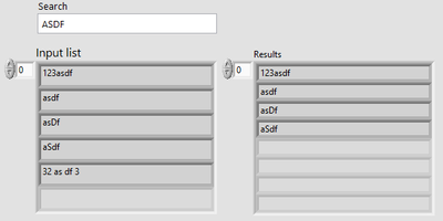

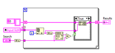

Here is my solution for the problem. I'm using arrays and convert all letters to lower case. The matching results are shown as they were before converted to lower case. Hope it helps to someone.

@BlackSupra wrote:
1. Why the Index Array inside of the loop?  Just use the autoindexed tunnel.
2. If using a newer version (2014?), you can use the conditional indexed output tunnel instead of the shift register, case structure, and build array.
3. Why in Input List using a local variable instead of the terminal?
