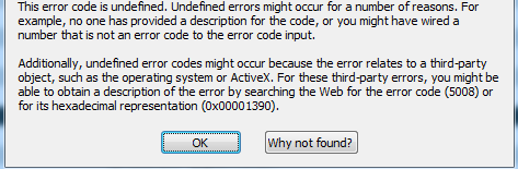

after the transition to the platform labview 2014 ceased to be loaded ActiveX components.
When I run the application crashes message

One thing that changed in LabVIEW 2014 in comparison to older LabVIEW versions is that it by default loads the .Net 4.x framework rather than the 2.x compatiible framework. Most likely your .Net server is not correctly configured to instantiate correctly in that .Net version and throws an error in its constructor that LabVIEW shows you. If this iis the issue, you need to talk with the developer of your .Net server, since that is really his fault.
Alternatively you can add a manifest file to LabVIEW to tell it to load an older framework version instead.
