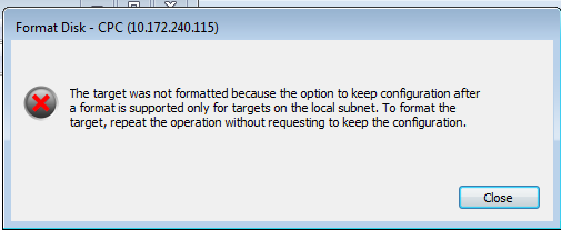

> Does your computer have multiple network cards?
Nope
> Is the dialog just a warning to remind you that you might need to reconfigure the network settings or does it actually prevent you from formatting?
Prevents me from formatting.
> How hard can it be to write down the network configuration, format, and reconfigure?
I know the configuration, that is not the problem.  This is just an irritant as it requires:
1. Format
2. Figure out what the new IP on the formatted device is supposed to be by digging out the manual and hunting around for it.  Unfortunately, the documentation is garbage-y and I always have to look it up when something like this happens (which is rarely, but enough for this to be annoying).  The new address isn't even something like 192. (which at this point seems fairly standard for LANs) but something like 169.  And to top it off, the thing comes up with DHCP active.
3. Grab a laptop and reconfigure the network settings to the new subnet configuration.
4. Walk into location where device resides, connect directly to the device (since now it is not on the LAN subnet).
5. Reset network settings on device.
6. Reset network settings on laptop.
7. Verify is visible on LAN now.
8. Reconnect and install software.
So, while not difficult, it is just plain obnoxious.  This used to work just fine, but this seems to be an issue that is occurring in MAX 18.0.
Here is what this looks like:

> If so, are you using a "Crossover Cable" (fairly rare, as they can not be used to connect a PC to a network)?
Yes, I am directly connected (port to port with no switch or hub between).  Cross over cables are mostly irrelevant on most new hardware that implement gigabit ethernet as most network cards with this have Auto MDIX enabled.  And, as such, I have had no issues interfacing directly with my hardware.  In fact, communication with this device is not an issue when directly connected; it only seems to disagree that it is on the local subnet.
Message 8 of 18
(5,930 Views)
> what the IP address, gateway, and subnet mask settings are on both the PC you're using and the sbRIO?
So the ip address for both is 10.172.240.xxx and the subnet mask is 255.255.255.0.  Since we are talking about the local subnet, the gateway here is not relevant.
