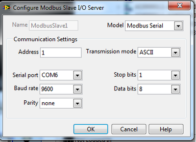

PLC (Master) - ID: 1
Network Speed: 9600; Data Bits: 8; Parity: None; Stop Bits: 1
Polling Table:
Transmission Mode - ASCII
Source Device - Master; Destination - Slave (ID:2); Data Type - Holding Register; Source Start Address - 30; Destination Star Address - 30; Length - 1
Labview I/O Server
When I peak inot the Distributed Systems Manager under the ModbusSlave Variable commfail is false. Error Status is 0, UPDATING IS FALSE.

From the above observations, it looks like the Modbus IO Server did not establish the communication with the PLC.
Check if the PLC supports the modbus connectivity
Check if the wire connected is correct and it is working
Check if the configuration details are correct
