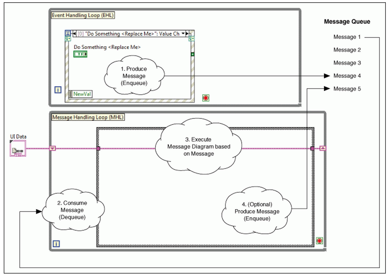

I found myself in a crossroad.
I have three different ways I can implement my code, but I don't know which can be better for my purpose.
I have a sequential program, where 2 parallel processes runs, at certain moment, one process have to wait each other to continue.
Which of these structures could be better?
1)controlling the processes and user button with a queue handling event?event-Message_Handling.png
3) having diffente cases inside a event structure (where all is in the default event, but for others send them to the different cases)EventDrivenState.png
and in all of the cases, should I use the value (signal) element to trigger my processes from events?

Message 44 of 60
(3,554 Views)
Yes there is canvas on having the Event Structure inside a case structure in a while loop.
But if you design correct and you do not use the "Lock Front panel" option on events, then you can have the Event structure in a case.
But I would go for your option 1.
