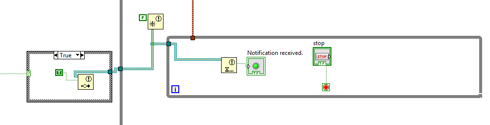

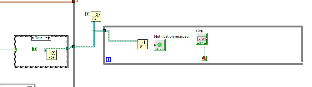

I am attempting to improve my logging code to be separate from the main UI/logic.
I was hoping to implement a 'Send Notification' upon my trigger, to start logging in a separate while loop.
To test this, I tried the following. When my trigger goes True, a notification is sent and my 'Notification received' boolean goes True.
When I wire anything to the while loop, this no longer works:
Can someone tell me why? I was hoping to put my logging logic into this while loop to grab data from the waveform wire (brown) to log my data.

Where is that waveform data coming from?  If it is direct from another loop, then that loop must finish before this logging loop can even run.  DATA FLOW.
You should use a queue to send the data to your logging loop.
