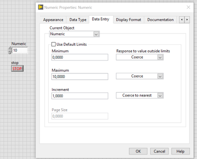

Yesterday I reproduced the problem with only a num control in a while loop. The control had the following properties (it also works with "coerce up/down") :

Hi everyone,
I thought the problem was gone but it is back on the source code this time. Today my control went from -150 volts (lower limit) to +150 volts (upper limit) in a single step while using the wheel of the mouse to decrement the value.
Another control with the same parameter worked as expected : it stopped at -150 volts.
