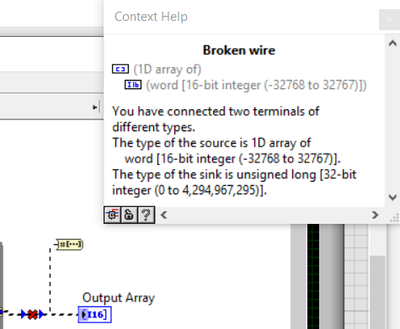

I have a 1D array of 16 bit integers (they are all 0 or 1's).  I would like to convert it to boolean array but when I try to use num to array function a broken wire appears:

Hi RFeng, I think that function you are attempting to use is for converting 1 numeric (not an array) to its binary representation. You can just use the "not equal to zero" function to convert your numbers into booleans.
Message 2 of 8
(8,034 Views)
It looks like you are using the Number to Boolean Array primitive.  This converts a *single* number to an array of Booleans.  One way of converting an array of integers to an array of Booleans is to just pass it to the Greater Than 0? primitive.  Any value in the input array that is greater than zero then results in a TRUE value in the output array.

Exactly. This is the only correct interpretation of the definition:
Quote from here:
"LabVIEW stores Boolean data as 8-bit values. If the value is zero, the Boolean value is FALSE. Any nonzero value represents TRUE."

I know that is the case in C/C++.  LabVIEW follows the same suite.  I can't say about any other language.  So, yes, "Not Equal To Zero" is the proper operation.
