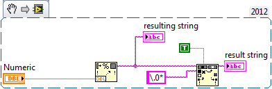

Hi Mark,
unneccessary complicated code is called "Rube-Goldberg" 😄
Try this:
Message 7 of 11
(8,245 Views)
@GerdW wrote:
Hi Mark,
Try this:
OK. Learn something new everyday.

Hi Johnny,
you should always note your (very outdated!) LabVIEW version when asking in the forum. A signature like mine might be a good idea too...
I cannot find an LabVIEW6.1 help online (with a quick search), so you should browse it on your own. What does the help tell you about those format codes?
When it doesn't mention the "#" format specifier you should try Mark's solution.
Or check your number by splitting at the decimal point and comparing the fractional part with zero:
Message 10 of 11
