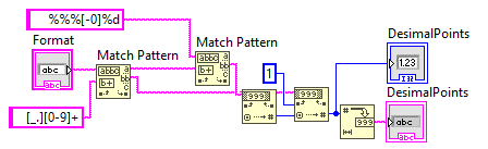

Number of desimal points I calculate like this:
And its work in many cases.

@0Forest0 wrote:
Number of decimal points I calculate like this:
So you convert two strings into numbers to figure out the decimal length.  Again, that seems wasteful.  Just convert the original number and use Search/Split String and String Length to get your decimal length.
