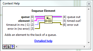

Number in Bracket Next to Terminal Name in Context Help
A while ago, I noticed that I have numbers in brackets next to the terminal names of a VI in the Context Help window.  I think this occured around the time that I started playing with VI Analyzer but I can't remember for sure.
Does anybody know what this is and how to hide them?

Turn off Additional VI Scripting information in Context Help window.  Options -> VI Server

Thanks!  I forgot that I had turned that on and that there was a specific check box regarding the Context Help window.
