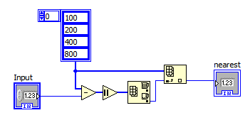

Here's one possibility (if two are the same distance, it will pick the lower one, e.g. 300->200).
It finds the element with the lowests absolute difference to the input. Modify as needed.
(The "interpolate 1D" function from the math palette also has a "Nearest" method)

Seems to work...

RSibagatullin, if you want to always round up if there are two choices, just reverse the array.
