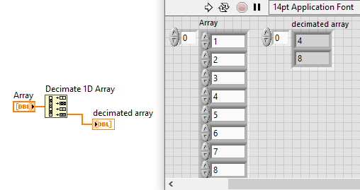

If I'm understanding you correctly you want every 4th measurement to be logged, but not all 10,000. (so like 4,8,12,16, etc...)
The simplest way is to use the node "Decimate 1D Array." You can resize it and take the 4th one. This will give you all the 4th measurements from the 1000.Solution.png

I think it's the right answer
thank you so much
