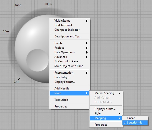

@bastlwastl wrote:
But then e.g. 2ms is possible if I use an increment of 1ms. But i wan't to restrict the values to 1, 10 and 100.  Or is the increment then logaritmic as well?
Use Logarithmic Mapping feature in th Knob control. Knob - Scale - Logarithmic Mapping.jpg
- Partha ( CLD until Oct 2027 🙂 )
