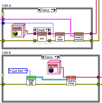

Here's an example from one of my applications - I have two CAN interfaces and either one can be a hardware interface (Kvaser / FPGA) or a simulation interface. You can see there are interface specific VIs which are called but the output of the case structures is the generic CAN interface object.
