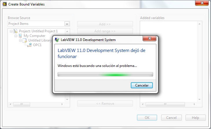

Because when I do an OPC server and I want to link the variables I get a message"Program stopped working" and closes all
I hope your help and thank you very much.

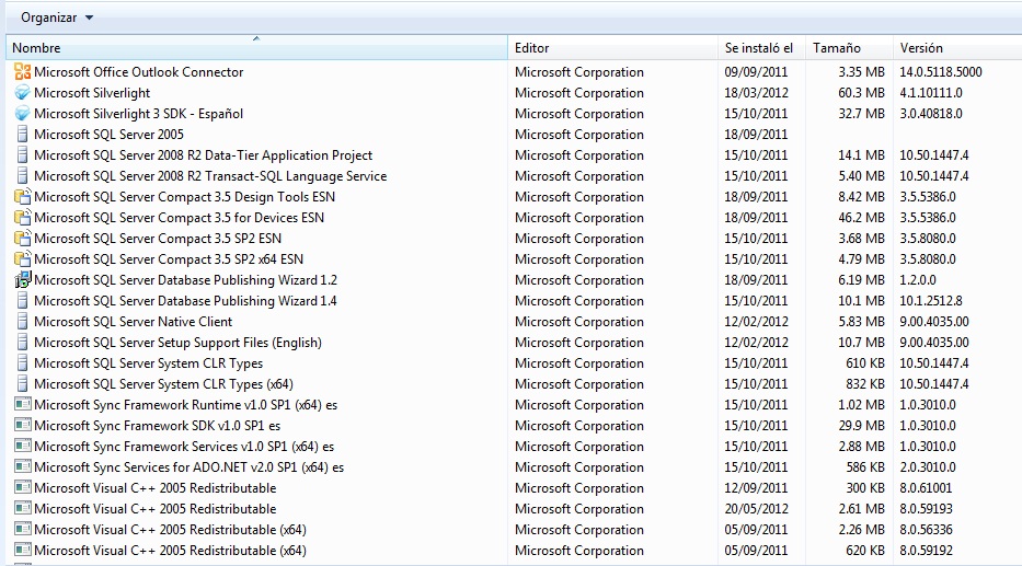

Are you using "Windows Server editions"??

Hi Danil33.
if I am using the following server .
(3,065 Views)

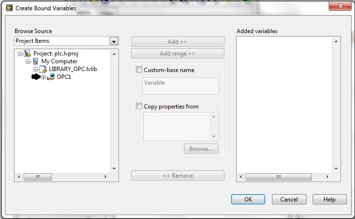

This is a bug. You can create connection to server than save everything, exit labview, open saved project and add variables.
Try it.
