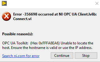

 So I'm trying using a simple connect and disconnect VIs, inserting the same address to the server endpoint URL input and a TRUE constant at trust any server input but I get an "Unable to locate the host" error

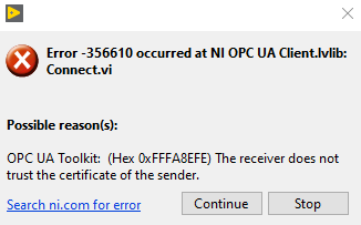

If I set not to trust any server I get
What should I do to make it work? Is there a  certificate file valid for all server or something similar?

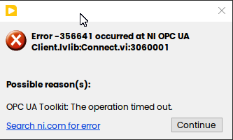

In case of wrong port you will get this:

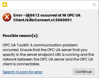

and in case of wrong IP address that:
