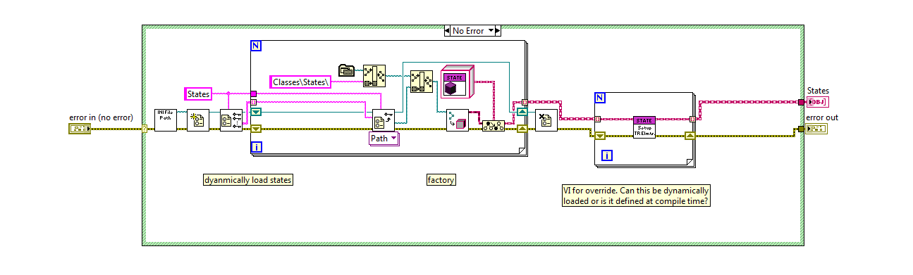

Is it possible to dynamically load an object's VI for override (override parent's method) after compiling code into an EXE?
I know it is possible to dynamically load objects with a factory, and this can add new objects to compiled code. However, the same doesn't seem to be true for a child's VI for Override. Does the compiled code include what specific implementations are known at compile time? Is there some way to get around this without defining all those VIs ahead of time?
To help illustrate this I have attached the image:dynamically load methods.png
On the far left, I load in the names of my objects via INI file values. This is useful because if I want to add new objects I can place the class in the appropriate file location and then load it with the ini file value and factory. This will allow me to load objects I did not define when I compiled the EXE. I run into trouble when I try to put the new object through the VI for Override. At that point, it calls the parent method, even if its method exists in its folder on disk. I am sure this is because LabVIEW did not know about that method at compile time. Is there anyway I can dynamically load its method after the EXE has been built? Or am I stuck recompiling my EXE each time I want to add an object with a new VI for Override?

The compiled exe will only include what is specifically referenced statically (ie directly in your code) or what you additionally include in the build. In your case, you are not including the .lvclass file or the vi methods of the classes you are loading by the factory pattern - these files must therefore exist on disk to be loaded at runtime. LabVIEW is not smart enough to second guess your intentions when you build a compiled exe - it's job is to ensure the the top-level VI you specify has all it's dependencies that are known statically (hence why you must include any dynamically called VIs that are needed unless you plan to load from disk).
However it is entirely possible to load LabVIEW files at runtime dynamically from disk - including LabVIEW Classes. When a LabVIEW Class is loaded into memory it always loads its contents into memory as well at the same time - including any method VIs (dynamic dispatch or not). This gives LabVIEW the ability to execute any of the methods that exist. If a LabVIEW class can't be loaded correctly (eg. the specified class file is missing or a file of the class is missing thus preventing the class from being loaded) then the default reasoning for Get LV Class Default Value is to not notify the user. You can change this behaviour with the "options" optional input. Have a look at the help file for this function.

I finally got some time to work on this and the issue was broken methods in my classes in the EXE directory. I fixed those broken VIs and it worked! I could add new classes and their new methods would work!
However, I'm back to where I was earlier. I can add new methods to existing classes and it still calls the original method that was used at compile time. Here is a quick summary of my existing setup:
1. It does not work at compile time and the correct overrides are not called. Will the LabVIEW dependency loading help me in this case? The method names are the same, so even if the old one gets loaded and not the new one, its the same name. I don't think I could tell a difference.
2. No broken VIs that I am aware of.
3. I enabled debugging and I can see that the correct overrides are not being called. However, the proper classes are being loaded from disk, they just aren't being used in the override methods.
Any other thoughts about this? I just can't figure out why it worked briefly, but now I am back to it not working.
