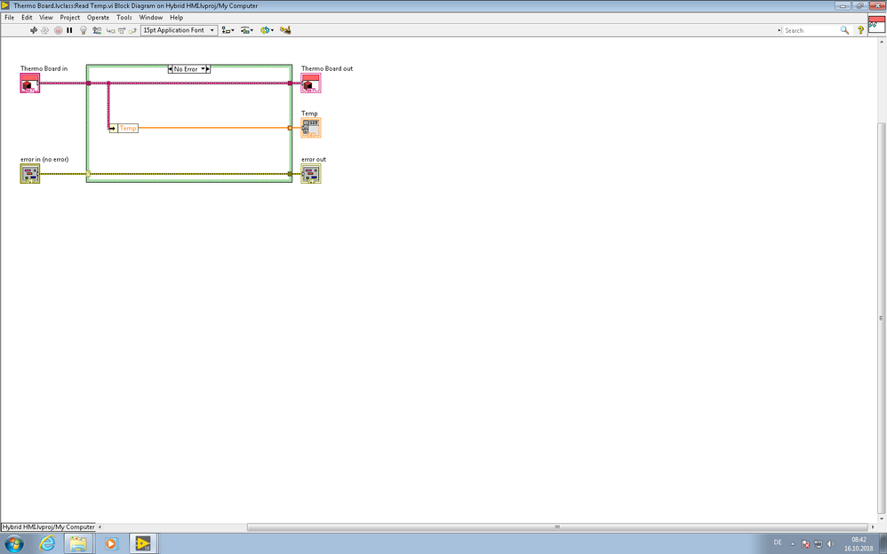

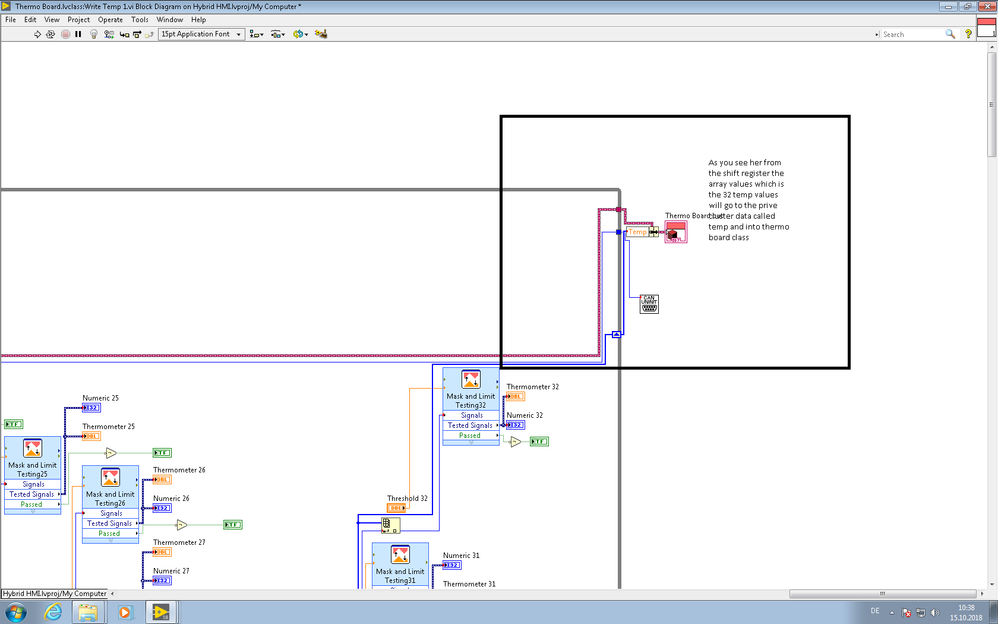

Iam sorry i didnt understand that line - the output class of your write temp vi to the input of your read temp. This is what I have done and also the value from the shift register goes into the private data temp which then goes into the thermo board out. In the read temp thermo board in is connected to a unbundle so that i can access temp. But I am not getting anything. The below photo shows the value coming in to the themo board out from the shift register.oop doubt.png

You're focusing (and showing us) details. The bigger picture might be the problem. (You're showing use big pictures, but that's not what I mean Smiley Wink.)
Show us where you call Write Temp2.vi and Read Temp.vi, that's probably where the problem is.
When Write Temp2.vi is done, is the Read Temp.vi connected directly to Write Temp2.vi? Use probes to see if the data is there when it exits Write Temp2.vi, and when it enters Read Temp.vi. My guess is they are not connected, and you might be assuming the data written in Write Temp2.vi automatically ends up in Read Temp.vi, even if the class wires are not connected. As if they are working by reference. They're not by reference, those objects are still working by wire, like any normal data type in LabVIEW.
But that's all assumption...
Message 7 of 20
(5,229 Views)
Yes I wired read temp to the end of write temp and it works. Now my doubt is this then what is the use of object oriented programming. If write temp and read temp were normal vis under a project without object oriented programming, wouldn't the same thing happen.
