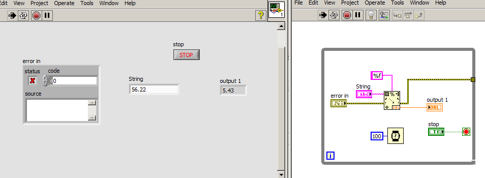

I'm probably just missing something simple, but this behavior suprised me.
I'm using LV 2013 32 bit on W7, 64bit.
The attached VI shows the problem, and is shown in the image as well:
First run the program, with some value (such as 5.43) in the string and NO error.  Then check the Error Boolean, and finally while it all is still running, change the string value.  (In the screen shot I changed it to 56.22.)  The error in to the Scan From String function prevents it from analyzing the string, as I would expect.  But the "output 1" retains the previous value of 5.43!  I would expect it to go to the default value of 0.  I see no mechanism for how Scan From String can be remembering its previous value.  Does anyone understand why it behaves this way?
I tried wiring the "default value 1" input with a 0, and then it behaves as expected.  When there is an error input, I get the default value I specified.  Makes sense.
By why does it remember a previous value when there IS an error in?  I would expect it to use the "default" default, which is 0.

I have reported a similar issue involving errors generated inside the node as opposed to fed into the node.  Either way the result is that the location in memory pointed to by the output terminal is not being updated in this case.  Since that location is reused nicely by the compiler inside your loop you will see that last value which successfully made it there.  Otherwise you would probably see garbage.  In my case, I had a default value wired, it was still ignored when an error occurred.
The response to my report to date is "That is interesting".  I managed to get them to fix similar wonkiness with Unflatten From String, hopefully this will eventually be resolved as well.

Darin.K,
I've attempted to reproduce the issue referenced here using LabVIEW 2014 SP1. When wiring a default value to the Scan From String Function and after the error executes, the function does return the value that is wired to the default input. So along those lines, I have not been able to reproduce that specific error. However, when the default input is not wired to the input of the Scan From String function, I was able to view the behavior described in the first post. When the error occurs, the scan from string function doesn't actually execute and the default value of 0 isn't actually processed. Thus, the indicator retains the previous value.

Will,
    Thanks for duplicating this.  Sorry if it was unclear, but I intended to convey that only when the default is NOT wired and an error goes into the function does the function output the previous value, unrelated to its current execution.  So you did indeed fully replicate the issue as I saw it.

For example, in LV2014SP1: error out but not default out.  Same issue as DaveT.

a) We are fixing the bug so that any time the node returns an error then the outputs will be the default values. Even though this also could introduce runtime issues to existing code, it is in a case where the error is already set and most code on error skips downstream work based on the scan, so we believe the risk of breaking user code is smaller.
The change was made in LabVIEW 2015 SP1 and will be in LV 2016.
