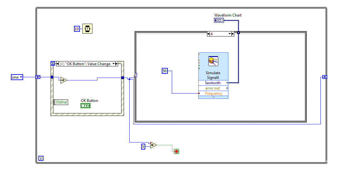

I removed the quotient-remainder function because when we set the constant to 3 and the elements are incremented (so we have 1,2,3,4), the resulting remainder would be 1,2,0,1 - which only shows the sine and square waveforms.
The only problem is the looping in which, after I click the boolean button 4 times, I would have to click it once more so that the loop would repeat again. This would be satisfactory if I run the VI continuously.
But anyway, thank you for the ideas. I wouldn't be able to generate this program without your guidance ^_^ although I know there are still some flaws.
