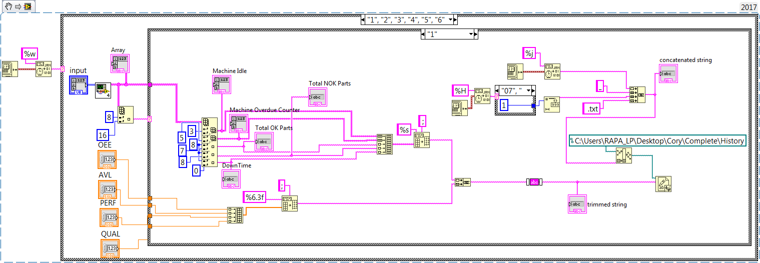

I put this together in just a couple hours so it is a little messy. But it's the main idea for the data saving VI. From here I would like the Data Open VI to take the date here I changed it to %j for testing but %d%m%Y is what that normally is. Again thanks for looking into this. Data Save.png

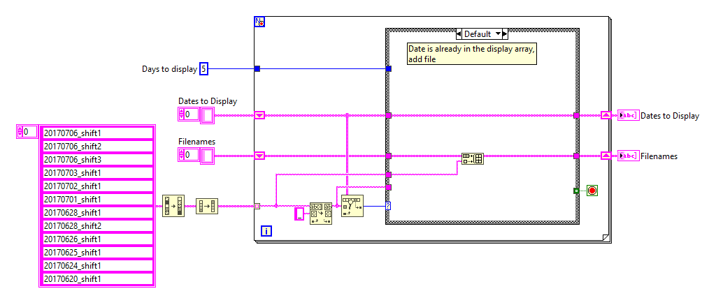

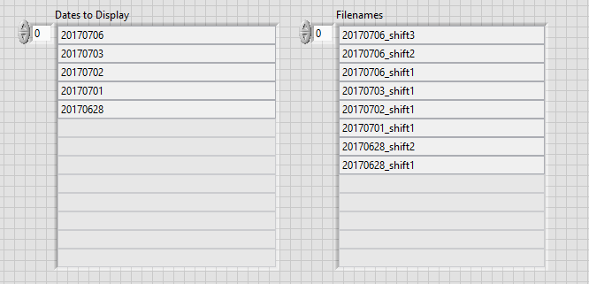

Once you have your list of files, you want the 5 most recent days. What I would do, is keep an array of the most recent days, and once you try to add the 6th one, stop looking through files. This assumes your array is sorted. I use a filename format like "YYYYMMDD_Filename.txt" most of the time, so that windows can easily organize by date. Here is an example to get you going:
(4,878 Views)
