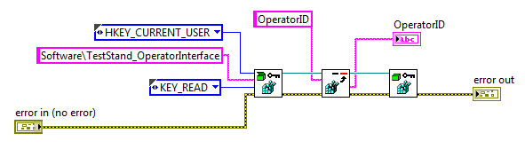

Open Registry Key VI. Error -604. But just under Run Time Engine (RTE) when no admin rights
When I run my code under RTE I'm getting -604 error saying remote access to registry denied.
To make it work I have to grant admin rights to the user, and then I can run my code under RTE.
The problem doesn't exist under Development Environment. The user can have no admin rights to be able access the registry.
OS: Win7 x32
Any suggestions?
