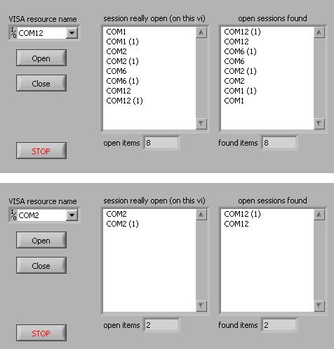

I would like to obtain a list of open visa sessions. I found this knowledge base article which should work, however when opening duplicate sessions (e.g. "COM6 (1)") the list contains empty entries or multiple COM1 references.
Please try the attached vi to see the effect; on my system the visa resource name control shows COM1 & COM2 (default system ports), COM6 & COM12 (2 USB-serial converters) and LPT1 (system parallel port) at start up.
This is shown after opening "COM6" (3x) > opening "COM12" (4x) > opening "COM1" (1x) > closing "COM12" and "COM12 (1)"
Maybe there is a way to read the contents of the drop down menu of the VISA resource control which contains all the information and is also updated automatically.

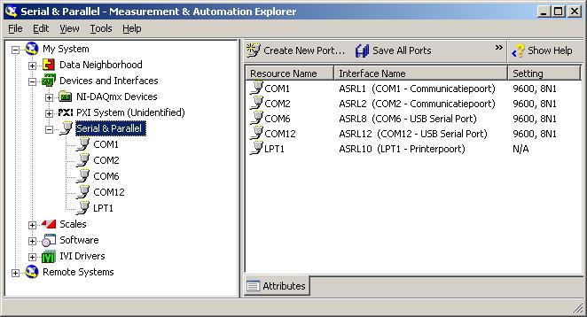

MAX lists ports 126 & 12 that I mentioned in my original postWhen running the example this list does not change (no "COM1 (1)" for exampleso I think this is just a list of physical portsnot the open VISA sessions
I think you forgot to attach the image but I guess this is the printscreen you're asking for:

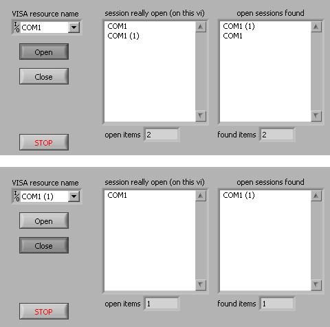

I've tried it on LabVIEW 2012 and it also does not work propperly:
I selected "COM1", pressed "Open" 2 times , then selected "COM1 (1)" and clicked "Close" with the following result:
I've tried it a bunch of times and it seems to me like just the bottom element is removed from the found list.

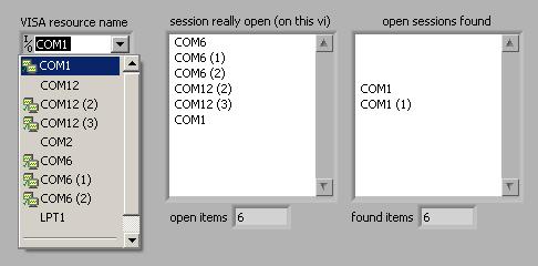

I also noticed something else, I opened all my ports 2x then closed them all in the same order they were opened (the found list looks like it is correct then). Now I reopened "COM 2" (2 times) and this is what came up:
Can you reproduce any of this behaviour? Now I know that it can work (on 8.5) I can't imagine there is something on my system that is causing this.
