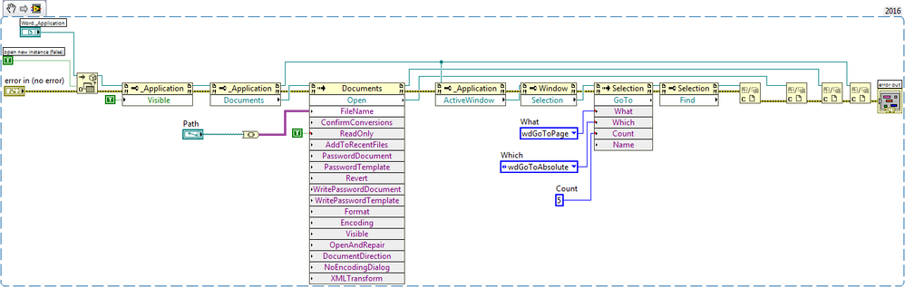

You were close, you need to apply the Go To method to the active window selection object and then apply the selection find property. Note that this doesn't work with a read only document (with a read only doc when you press F5 the Go To dialog will not appear either [Word 2013]).

Although that code didn't work for me (at least not for read only);  it did give me an idea when I was about to give up and go home!!  The Range>Selection!
I attached code for opening word at either a page # or at a header.
(The header option will search all headers and will match the first one that contains the input string (you may have to play with this))
Was stuck on this for 5 hours, and was about to abandon this method..
Thanks!

Thanks for sharing, shouldn't the wdGoToHeading constant be in the "Go To Header" case and a wdGoToPage constant in the  "Go To Page" case?
Ben64
Message 7 of 12
(5,425 Views)
Jeez your quick!
Yeah, I actually noticed that right after I posted haha.
I managed to edit the linked VI in the post above.

I think you can copy the code from the picture provided by ben64.
