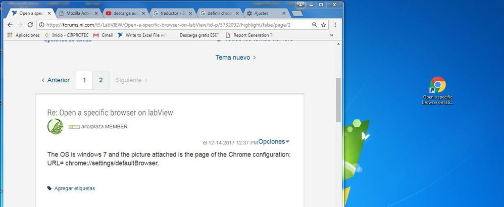

Open a specific browser on labView
The OS is windows 7 and the picture attached is the page of the Chrome configuration: URL= chrome://settings/defaultBrowser.

If you drag an url to the desktop as a shortcut, does it have the chrome icon?
Message 12 of 20
(6,363 Views)
Yes, here the example of the topic we are talking:
Message 13 of 20
(6,359 Views)
Sorry, I am out of ideas. If you open IE, does it complain that it's not the default browser? Maybe there is something corrupted in the registry or it has to do with the os language.

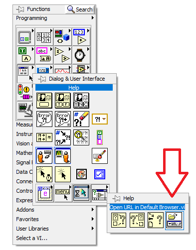

I mentioned that in the first answer above and I thought you were testing with that one.
There is no need to dig through "libraries" and pick a specific polymorphic instance.
That VI is in the palettes! (Dialog&user interface...help")
