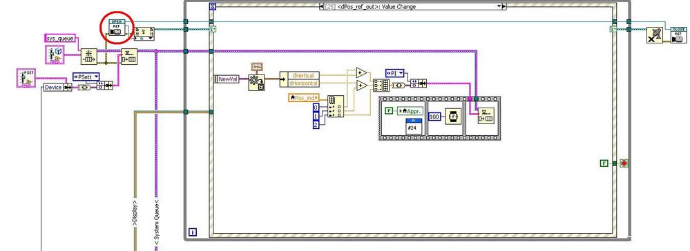

1. I'm building an exe of my main VI. When I run it as exe on other PCs, it doesn't open the subVI (cam_pos_test.vi) (on my PC is everything running ok). The cam subVI is added in the always included VIs, when I build the application. Part of the main level VI looks like this (control/producer loop):
in the red circle is the subVI which opens the Ref to the cam_subVI. It looks like this:
I think: I make some error in the defining the path of the subVI (cam_pos_test.vi). Do you have some idea, what could be wrong? Why the cam_pos_test does not pop-up as it should on the other machines? 🙂 I've tested the cam_pos_test.vi as exe is running on other PCs.

Are you sure that the path to the VI you are trying to open a reference to is correct ?
There are difference in the path the "Current VI's Path" constant.is giving you depending on if it is an exe or development env.
Make sure that the path is correct for the vi.
